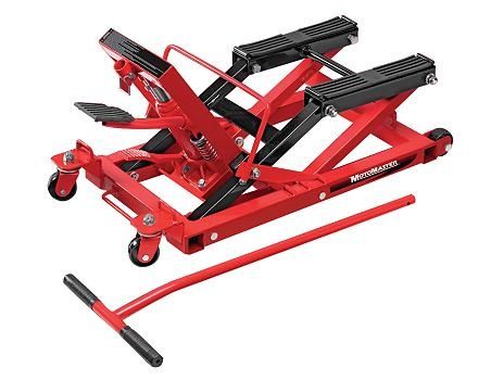

#9 ·
Pulling the motor is easy, if it's a track bike. With a cruiser style motorcycle lift you can remove and install the motor very easily. Buy the lift and return it after you've used it for 30 seconds. I had mine in, running and prepped for a race in 8hrs (different bike but it's still a bike), removing it takes much less. I would spend the cash and fix it before parting out but it's your bike and your decision. Good luck.
