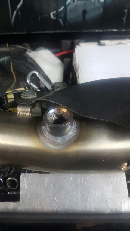

I'm asking your advice where to install wideband o2 sensor? I have stock header, Akrapovic titanium link pipe and slip on.
I marked few possible locations.
I've understood if I use wideband to narrowband adapter and mount o2 sensor to stock location, reading are not reliable?
I have also difficulties find welder who could successfully weld bung on thin titanium link pipe.
I saw there are "no weld o2 bung mounts" available. Are are these reliable? Lifetime / possible leakages?
Should I remove stock narrowband bung and weld wideband bung on stock location?
I would be very grateful for all recommendation / advices.
