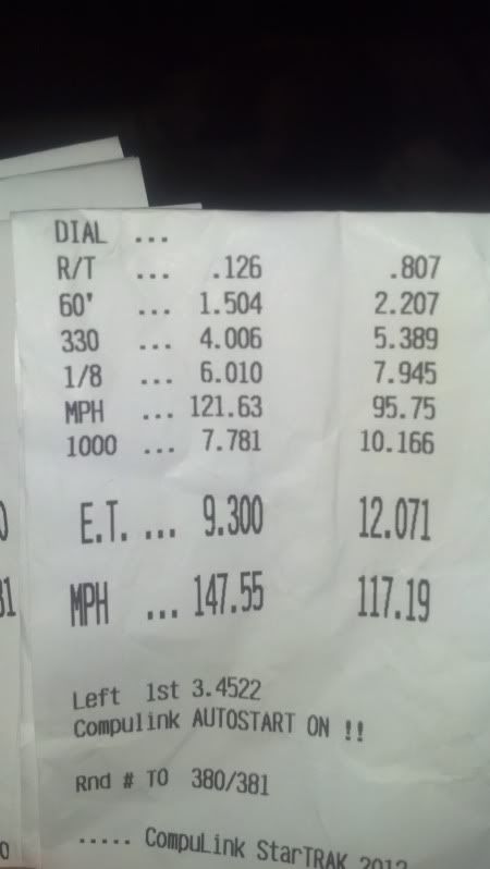

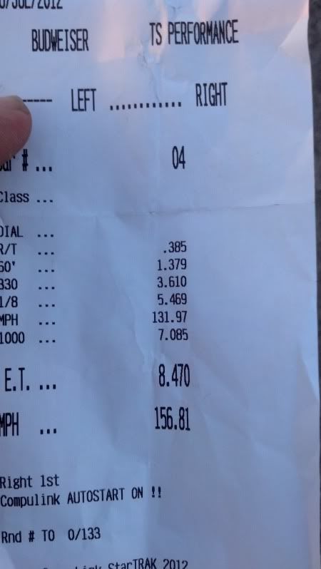

well i went back to the 1/4 last night with the new clutch and tune and the same mph result. kind driving me crazy
i didnt make but a few passes cause the track was packed and i had a nitrous leak and wasted most of my nitrous.........yep shitty
only had one decent full pass and it went 8.47 at 1.46
at the end of the night i made a couple motor passes and went 9.30 at 1.57
keep in mind that i didnt have motor gear in the bike, i had gear for spray
here are pics of the slips
rundown i am 220 suited and the bike is a 04 zx10 head and cams with about a 45 shot.
am i crazy in thinking the mph should be higher.

here is all the info on the bike
Mods include,
Motor:
Port/Polished Head
Titanium Retainers and springs
modified and milled throttle bodies
Kawasaki Race Cams
Angle cut valve job
Shaved Head
Removed butterflies and secondaries
Shallow Oil Pan
Low 1st Gear Mod
welded the rivets on the basket
welded the inner basket to eliminate the slipper
has a modified drilled inner hub for more oil flow
milled release pin
up the oil pressure a bit
factory pro shift kit
new clutch
pingle air shifter
pingle killbox
rifleman 1/5 trottle mod
brocks sidewinder exhaust
Dynojet PCIII with hub
ZX-14 Front Brakes
Stainless Steel Brake Lines
16/44 gearing
EK ZZZ chain
marchisini forged magnesium wheels
busa shock
antigravity battery
soupys adjustable lowering links
miffco rear tire hugger
evil swingarm 18 over
45 shot
cometic nc-2 controller
gixx1300 spraybar
dynojet hub
ignition controller
wegoIII wideband

Your ET seems to be about right for both passes. Nitrous MPH seems a little low, but I'm no nitrous expert so I don't really know for sure. Motor MPH doesn't seem too far off. I have similar mods and mine is running 149-150 in the heat/humidity on the U4.4 and I'm 185lb.

If your WEGO log is showing the tune is right, then I would start looking at the nitrous system components. Just to double check and make sure everything is up to snuff there. Just a thought.

Cook, Im curious, what gear/RPM are you passing the traps?
779 Posts
Check your stack height (clutch) losing mph is a sign that the clutches are about to go. Could be slipping on the gas, I had this happen to me before I think my stack height was 52.7mm when it started slipping. I pulled most of those fibers out and reused them later when I stopped spraying the bike and they were fine on motor.
