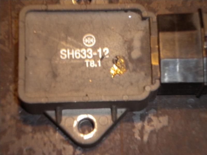

it's a quick and easy, two bolts hold it on, plug and play. should be under the seat or on the side near the pillion seat, not sure of the location on the 10R but they have to be somewhere that gets some air flow, cuz they do get hot.
this is the CBR Reg/Rec, notice the little "spot" where the magic escaped.
this is the old and new, on the CBR it's on the right side, behind the faring near the pillion seat.

Hi Rifleman, thanks for those pics. I'm anticipating the worst case scenario now and thinking my stator is cooked, reason is the charging output has now dropped to battery voltage, 12.60 volts, zero output from the charging system. My Reg-Rectifier unit failed high and then went to zero, so I'm guessing to do that it must have shorted the stator coils out. I can't see anything in the R-R unit that would fail and shut down all voltage to the charging system unless all six diodes in the bridge rectifier opened. That is a possibility I guess, only way to know for sure is pull this thing apart and check the stator output voltage at the R-R unit. The Service Manager said the output should be about 70 volts AC across all three phases taken in pairs when revved up and the voltages should be very close between the phases. I'll keep you posted on how this all turns out. Man I wish I 'd taken it in early and gotten that R-R changed when the recall first came out. My thoughts were I've been riding it for 7 years with no issues, maybe I dodged the bullet...lol!
1,913 Posts
Discussion Starter · #19 ·
Update: My dealer replaced my voltage regulator/rectifier under a recall on Tuesday morning and the tech told me the bike is now charging fine, rode it home without further incident.
The reg unit was melted down, had a hole similar to the Rifleman photo.
