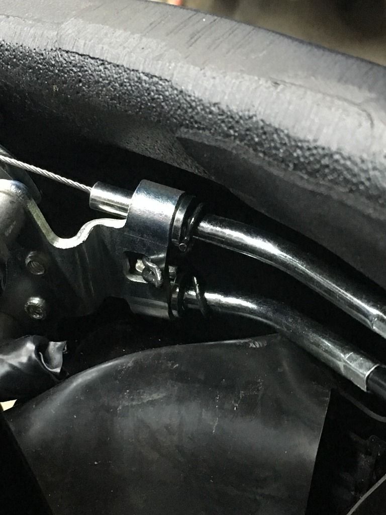

I did the throttle kit install and I bent the clip that holds the throttle cables to the sensor. I spent some time bending it back but it just didn't want to go back to the way it was originally no matter how hard I tried. I'd rather just get a new one at this point; however, I combed the Kawasaki microfiche online and just can't seem to find it anywhere. Anyone have any idea what the part number on that little bugger is or what part diagram to look under?
FYI, the throttle line clip is not available on it's own. You have to buy the whole throttle body assembly to get one from Kawi so be careful with the clip. I fixed mine best I could since I'm not paying hundreds just to get a clip...
This is what mine looked like when I reinstalled it:
Sent from my iPhone using Tapatalk
