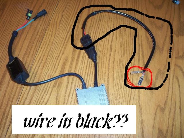

Ok guys installed the fuking lights, turn bike on no lights, wait a few secs no lights shut bike off
the two connectors go to the light bulb, got that installed the bulb, connected all as is, but the circled area does not fit the housing for the stock power source where the old bulb was connected
did I get the freaking wrong ballast

I think the wrong part of the kit is the lone wire that goes from the ballast to the stock power housing of the headlights

make sure the part that connects to the bike are connecting to the correct colors normal headlights are not polarized ( positive negative) hids are
798 Posts
and if you want to you can cut up the harness and hard wire it since they do give you a plug

That looks like an H7 kit to me.
1,823 Posts
agreed, starrotors is a good company, make sure you ordered the right size, if thats still not the problem im sure you can send the wire that goes to stock back to them and they will send you the right one, u dont wonna hard wire it you will void your warrenty if you cut any of the starrotors kit
hmm before anything I would call Rick from Starrotor just to make sure that the wiring kits for the h7 bulbs are the same as the h9, If they are from what i see in the PIC have you tried to tun the Female connection around when trying to connect it to the stock power source (I know dumb question but hey second Mechanic coming thru) also it seems that two little plastic pieces that connect to those two little metal pieces I know that doesnt sound right but can you take a PIC of all the parts that came with the Kit please

The harness from the ballast to the OEM headlight plug is a generic harness, it fits everything and requires splicing to fit. Most of these cheap kits come that way as H11 isn't as common. A quick fix is to get a headlight plug from a 9005 or 9006 bulb type and splice it to that HID harness and it's an OEM fit. I have an extra one at home pre made so if you need one let me know.

ninja I have the stock bulbs still, would I be able to splice the generic connectors to the stock bulb connectors somehow
thx

hey guys if i do splice which wires are the positives
I know on the hid kit the red is positive
on the bike there are four two for each headlight
there is red and black for low beam, and blue and black for high beam??

Dude just call Rick from Star rotor. he will help you with the kit.

Rick shipped out new connector wires to me
thx for all the help

the plugs fit but its a really tight squeeze. you have to push it in hard till u hear the click. i mean hard. the plug from the ballast is tight but definitely works. a couple of guys on this thread went thru that problem. correct plugs but push that sucker tight till the fastener clicks

the plugs fit but its a really tight squeeze. You have to push it in hard till u hear the click. I mean hard. The plug from the ballast is tight but definitely works. A couple of guys on this thread went thru that problem. Correct plugs but push that sucker tight till the fastener clicks
:+1: Push

ninja are you saying the ones I have already will fit
wont fit man, I tried hard pushing them no click, I even took teh plsstic guide out of the stock female housing, no luck
I think the new connectors will be fine once they come in
thx guys
