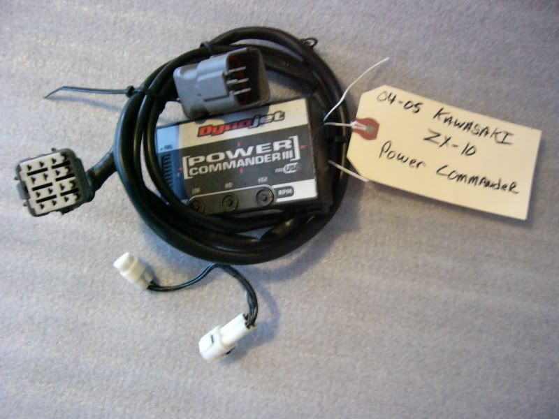

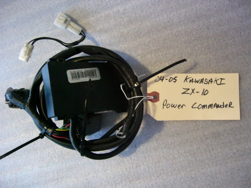

Just bought a used power commander looks like everything was there
How about to you guys does everything seem to be intact?
what is the little short 3 inch double plug wires for?

small white plugs into tps (front left under air box), big plugs are for fuel rail (bottom right air box), little guy goes to battery. done deal. and in case pictures are your thing, look at link, explains it perfectly. also, when you plug it all in, turn the key to on position, make sure green lights come on pc3, should be all the way at the bottom. then, turn bike on, rev throttle a little bit, make sure lights move up and down with throttle correctly. you need the install software for your laptop, load it up, zero out the map and then go to a dyno tuner to have it done properly. maps need to be custom made for each bike.
http://www.powercommander.com/downloads/212/install/411/eng212-411.pdf

thanks I understood most of that before buying, Just wanted to make sure most wasnt missing. Youve been a big help on the link thanks.
