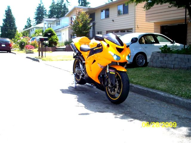

OP, i have your pearl solar yellow paint from www.colorrite.com
1/2 pint base for pearl, 1/2 pint paint....which should be enough for both lower fairings....i bought them to paint my lowers...but i have a lil crack on my right lower from some idiot driver backing into it and tipping over.....so i put some decals on it for now...:crackup::lol:
