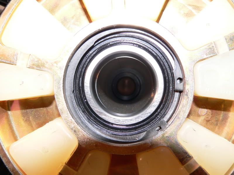

I received my magnesium wheels and when I unpack the rear, I found this seemingly misaligned rear bore.
The wheel bearing and the bore are definitely offset from one another. This is looking through the cush drive side.
I'm thinking trying to force the spacer through this would either 1) put undue load on the bearing or 2) not fit at all.
Any thoughts??? Am I mistaken?

I dont believe the spacer goes through the sleeve/bore. I believe the sleeve/bore will align with the inner bearing if you move it with your finger.

Oh, the sleeve moves in there? :rolleyes:
I think the spacer does cross the bearing and into the sleeve but don't quote me on it.
If that's the case, thanks! Scared the crap out of me. :eyecrazy:
I didn't want to bang the sprocket drive in and everything be seized up.

Yup, the fu*ker moves in there.
