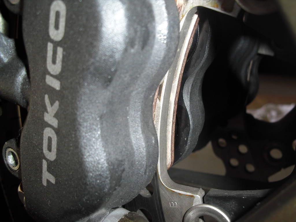

Here are the calipers loaded with the EBC pads after a complete cleaning.

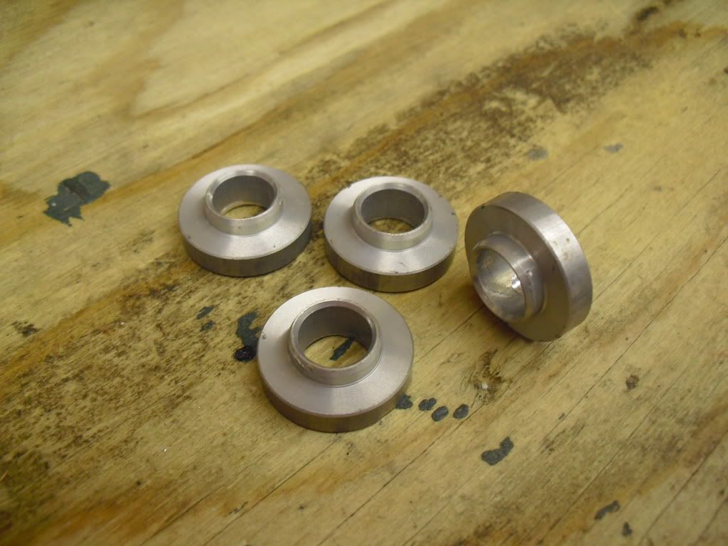

THe calipers came with brand new OEM Honda spacers- they have the little shoulder on both sides- in order to make them work on the Kawi forks you need to grind off one of the sides of the spacers- I used combo between a dremel and a grind stone on a regular drill. After some patience they came out nice. Notice you will want to ensure they are totally flat so the caliper mounts correctly to the spindle.

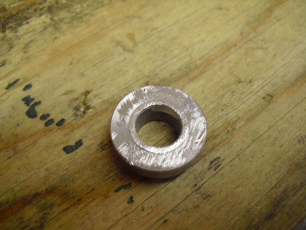

Here is the modified spacer- you need to do this to all 4...

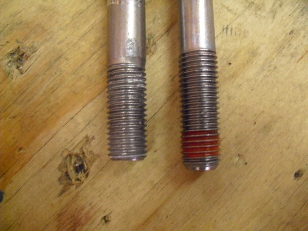

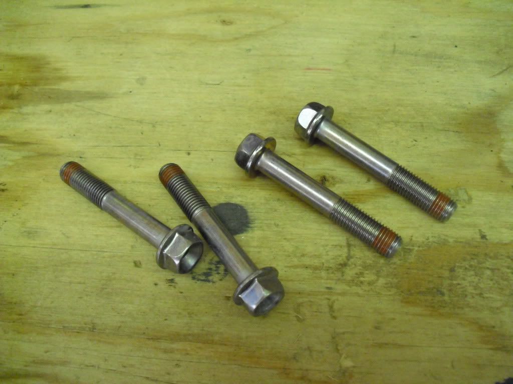

THe first issue I came across was getting the stock Kawi bolts off- They require a 6mm hex socket- what a fucking pain in the ass- the first bit I snapped in half because it was on there to damn tight- I finally got all 4 off but 3 out of 4 were stripped. So I had to order OEM Honda caliper bolts for the price of.......$52 for all 4... :badteeth:. Here is a pic- notice the thread lock on them... (nice touch Honda)

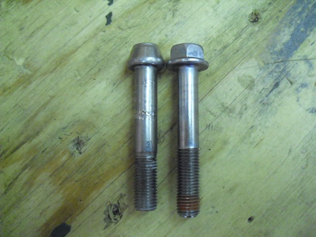

THere has been some rumors about lenghts- Here is the Honda vs. Kawi bolts.. Honda is a little longer..

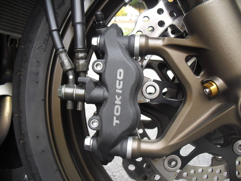

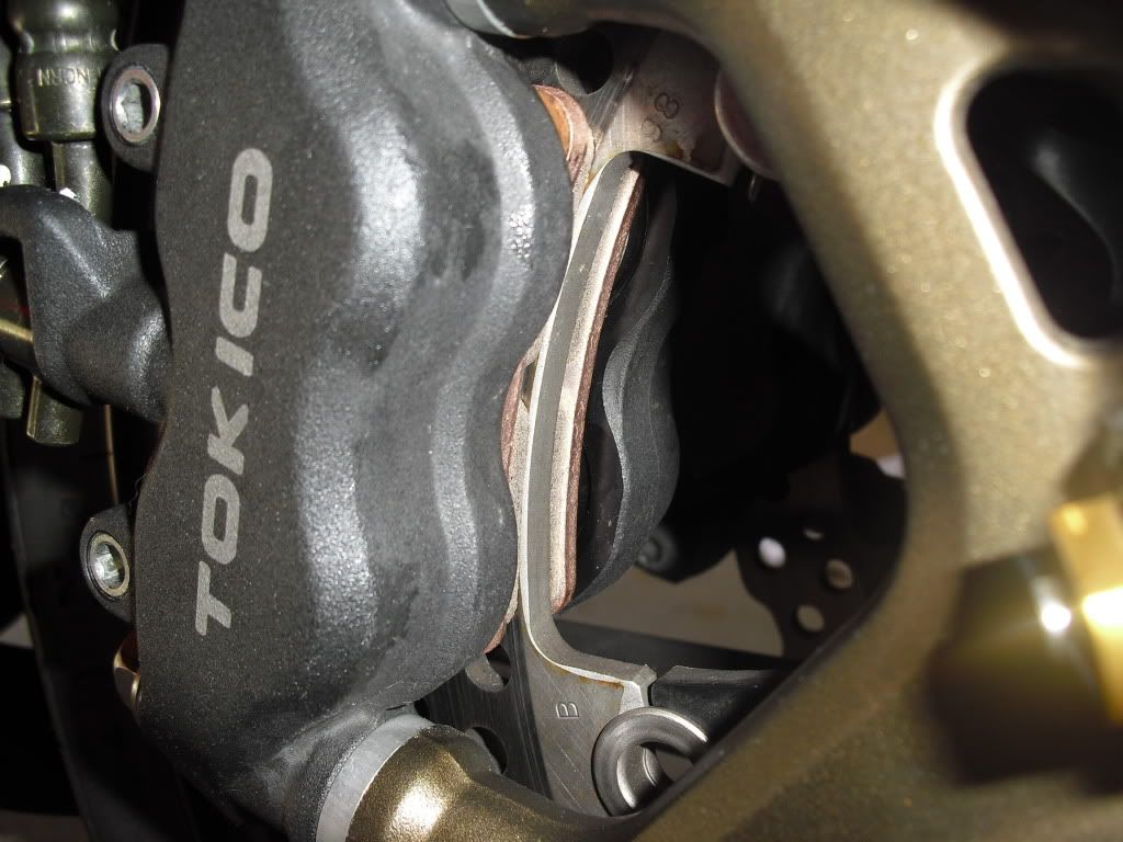

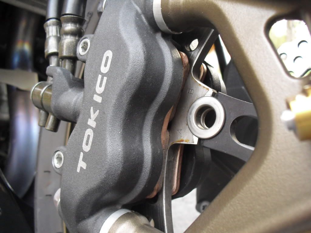

The Honda spacer placed the caliper perfectly with the rotor as you can see from these pics..

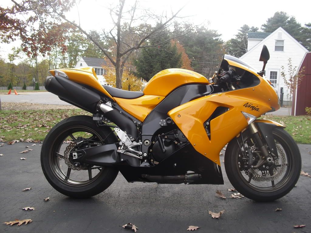

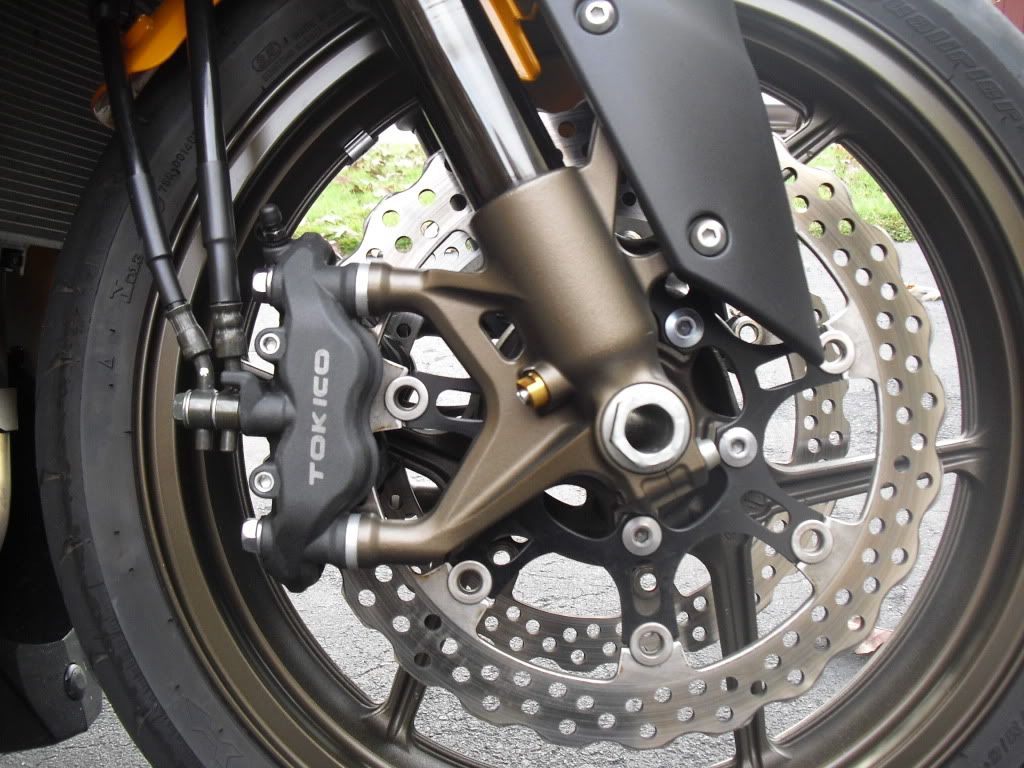

Here are pics of the finished project- I am just waiting for the front Galfer lines to come in.
I took it out for a ride and can defintely feel a difference although the pads are still getting bedded and I didnt go too far. THey are a lot better then stock but with the Galfer lines I expect even better performance. THe rear is WAY easier to lock up with the Galfer line. I was surprised considering the bike is an 2006 and only has 3000 miles on it.. This winter I am going to get some Stompgrip for the frame where my knees hit as I slide forward now when I hit the brakes more then before.
