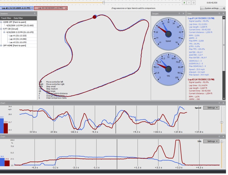

Track maps for full data analysis makes it easy to find where your inconsistencies out on track are located, which helps the rider focus on improving in those areas. Two laps is all it takes for the device to recognize the track and automatically set up a start/finish line from which to calculate lap times. This can be further refined by allowing you to program up to five splits within the track map so you can easily see the results of changes to your riding or set up within each sector.

Set up your own screen layout because you don’t need everything in your face when you’re on the bike, or maybe you do – whatever you want, you can easily configure the layout with the included XTStudio software.

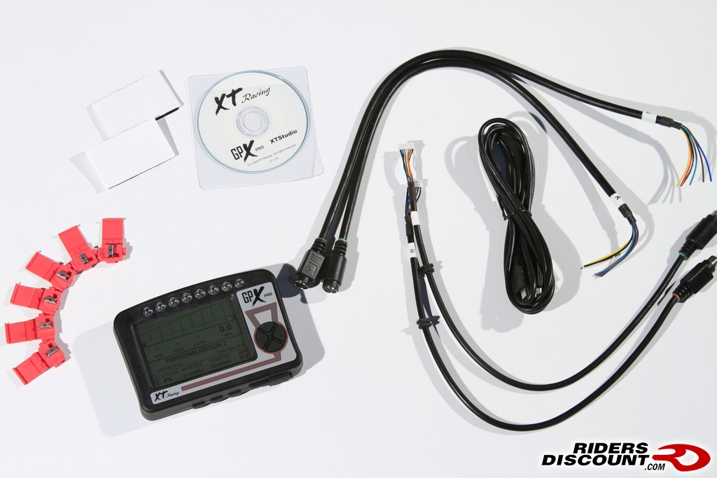

Everything that’s included with the GPX Pro.
Out of the box, you can use the GPX Pro for calculating lap times without the need for a trackside beacon. With a little bit of wiring, you can really take advantage of the GPX Pro’s DAQ capabilities.
You’ll want to spend a lot of time looking at the wealth of information a fully set-up GPX Pro system can provide with the included XTStudio software. This data is imperative if you’re serious about improving your riding as it eliminates the guesswork of what’s happening out on track. Simply select any point along the map to see what you’re doing and take advantage of that knowledge next time you’re on track for improved performance.
