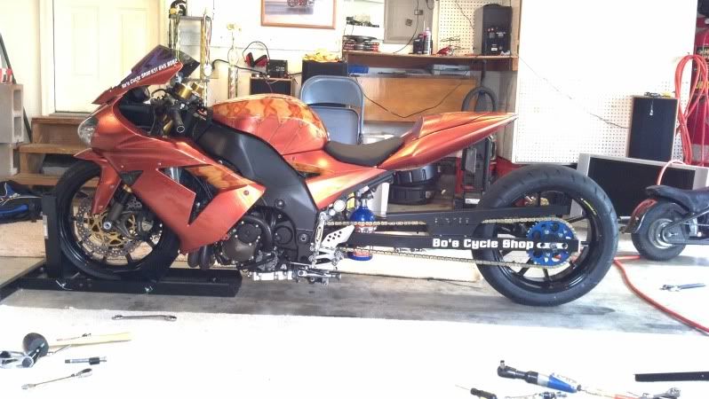

well the lowness is almost complete. just have to wait for it to dry out to see how it rides. the seat is 26 inches off the ground

it runs 8.40s in the 1/4
going to the 1/4 again this week so we will see if the new parts help.
i still ride the bike everyday so the seat padding thats left will stay. got to have a bit of comfort left.

yeah it about a 45 or so. its a 38 jet, the 34 jet was 40whp
i actually ended up buying the link that you sent me.
on the one that you are running did it stiffen up alot? man it made it sit way way lower
i have my soupys all the way turned in and this is as high as it will go. i may end up ordering the other links from soupys cause the ones i bought were designed to where you could lower the bike more than with the standard links
yeah, definately stiffened it up quite a bit, but it makes since...essentiallly compressing the shock more. Another trick is to get a set of adustable Busa links off ebay for @$70 shipped...they are shorter and will work for what you need.
