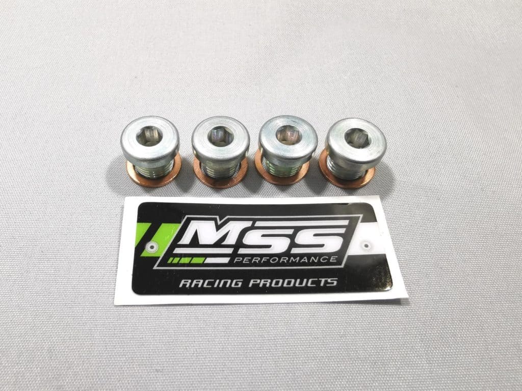

Its super easy to remove the abs out of it. Like others have said, remove lines plug the holes in the unit (i cut up pieces of my wifes tampons), and run dedicated lines to the mc. I just installed a brembo 19rcs and spiegler lines. One hell of a change in braking.
