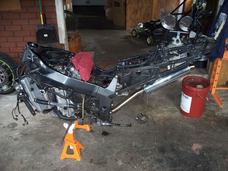

Recently completed a full Gen III zx10r suspension upgrade for my '02 zx7r P model (forks, wheels, brakes, swing arm, shock, etc.). Man, what a difference.
Before:
During:
After:

what kind of mods did you have to do? cutting or welding for the shock links?
swing arm same width?

I Had to make a few custom spacers to compensate for the difference between the 7r swing arm pivot shaft and the 10r. Fortunately, swing arm width at the pivot are identical between the 7r and the 10r. I had custom dog bones made from 6160 aluminum to help raise the rear ride height.
I used an '06 zx6r upper triple clamp so I had to make a custom spacer for that as well in order to get that to mount up correctly. Also had to do some modding to get the ignition to fit the 6r upper triple.
I posted the full build thread on the ZX forums if you're interested:
http://www.zxforums.com/forums/zx-7r-forum/94138-project-suspension-upgrade.html

Everything is coming back apart this winter so that I can paint the frame, swing arm, and wheels (to keep the color more uniform). In addition, (since removing the front wheel on a 7r means you're removing the speedometer drive cable) I'll probably be installing a Koso gauge cluster and a few other goodies.
Awesome job! Must handle like a dream too
She does. Significant improvement in cornering, overall ride, and especially braking. Not to mention reduced weight (especially rotating mass), which could be a large portion of the previously mentioned benefits.
