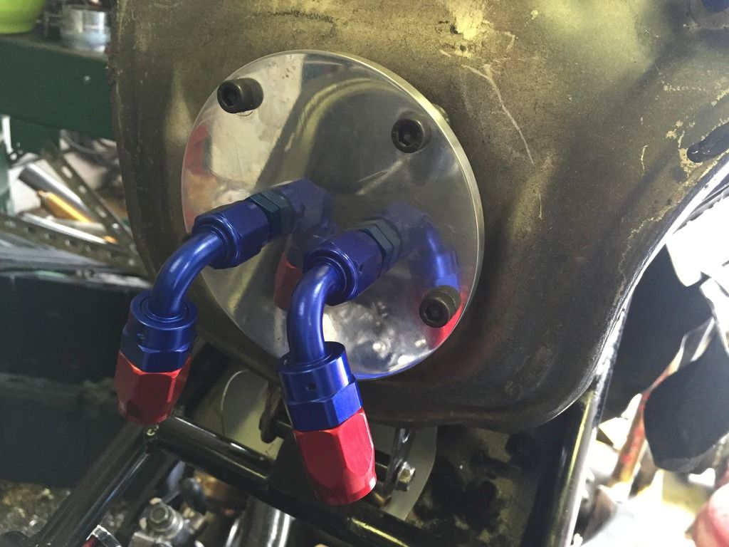

My fuel system is external so its cnastantly flashing "FUEL" how do i bypass this?

The low fuel indicator is resistance based... an open circuit will flash the low fuel light. You can either put just the sensor/tower back in the tank, or ground the indicator wire in the harness. If you still have the stock base in the tank you can rig up the level sensor to work without the pump...... I'd recommend that if it's a bike you still ride around on the street. :)

i dont have the stock base i have this one i made. but now that i think of it maybe its best to try and put the sensor inside somehow.
If your not going to be monitoring fuel why don't you just cut or disconnect the Fuel Line sensor wire on the input of the Gauge Cluster it's all in the manual which line? :dontknow:
