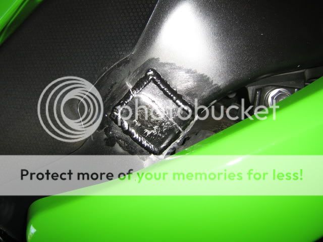

okay, from doin wheelies and endos with bad forks, i seem to have cracked my frame pretty good. i had it welded ( that lasted one wheelie) so i ordered and just recieved my new frame, for my '04. how difficult is it to make this swap?? with tools and a brain can i do this shit myself?? btw, i had my forks resealed and fixed. im goin to try post a pic of my craked frame. my buddy said we could swap in a day another said not to attempt it ?? wtf?
