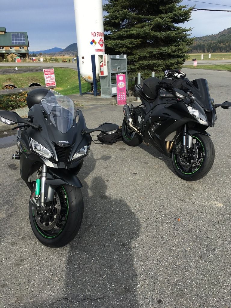

Hell bars made a huge difference in my ability to ride long distance. I mean ride as long as I want to now. Only thing that stops me is my knees after around 300 they start acting up. I also installed a throttlemeister cruise control. It's a bar end weight that turns to lock the throttle. Can't even tell it's there. Looks just like a heavy bar end weight. I could get you a close up later but you should be able to see the helibars and cruise in this picture. If you want any other angles I'd be happy to help just PM me and I'll send to your phone or email

Kllongbrake: Your bike looks really cool! I will PM you as I would need some pictures in different angles. Are you saying that you are able to ride longer? How much distance were you able to ride with the stock clipons? Did you have to adjust the rearset? And how do Helibars perform at the track?
