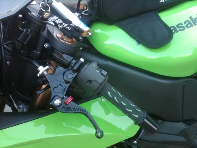

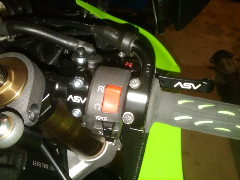

I finally got around to installing my ASV levers on my 08' ZX10R and couldn't be happier with them. A week later my ASV rotator clamps arrived but only the clamp for the brake lever perch fits. rotator clamps have a plastic sleeve which allows the whole lever/perch assembly to turn up or down if you happen to go down on the bike so this along with the ASV levers unbreakable feature equals greater protection. ASV customer service said the clamp should fit both sides on a sportbike but the clutch perch clamp has a wider bolt pattern than the brake perch so it wouldn't fit. Hopefully ASV can make a clamp to fit the newer bikes in the near future. part numbers and pics are below
ASV Levers - Brake BRC511SK
Clutch CRC541SK
Rotator Clamp - Brake RCU01K
Clutch (neither RCU01K or RCU02K fits the 08-09)
