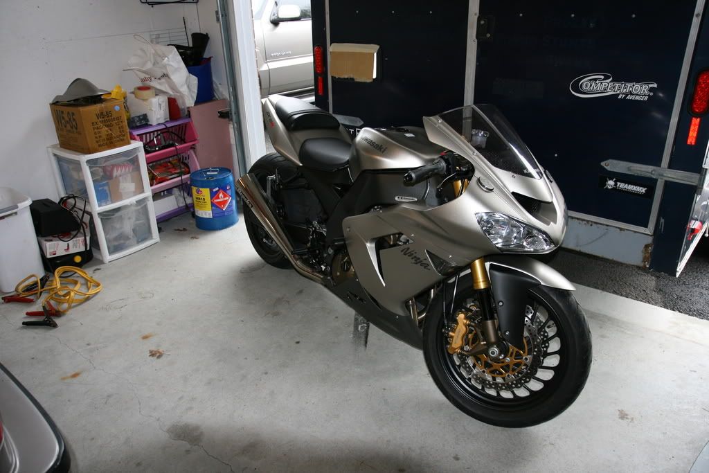

What's up fellas? I am new to the forum & just would like to hello. I own a 05 ZX-10 & was looking for some info on some racing cams. Want to install some web cams,thinner head gasket and bump up the comp. Looking to get an extra 20RWHP. Any recommendations

Nice 10 man!!......super clean!!.....

:+1: on the good looking bike. 20hp is going to take more than a cam and head gasket. Full out head work with full on cams and a 3mill bore will get you closer. As far as compression goes, the thin head gasket will raise it a little bit but for those kinds of gains, you will need a decked head but you may be running a volatile compression by then. I wouldn't suggest decking the head because you are going to end up rebuilding the engine before you know it. However you will get a decent gain with cams and head gasket (~10hp on a good day).
