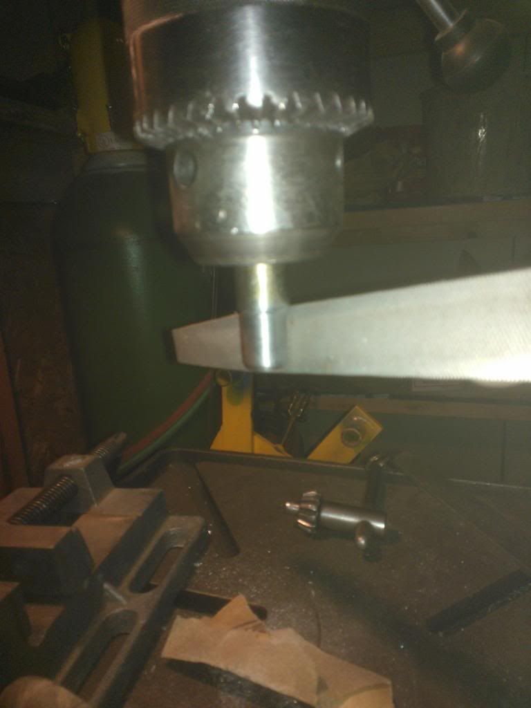

I can't speak for a Gen. 3 but my Gen. 4 uses a 19mm pin. I bought the cheap Harbor Freight (?) one and took the one pin that was just a bit too large and chucked it up in my drill press and filed it down 'till it fit perfectly. Hillbilly machinist right here!

If 27mm is correct and you were using an 18mm pin then that would be waaaaayy too much slop. I don't remember exactly but on my Gen 1 I used one pin and sanded it down to make it a snug fit then I didn't have any issues with the stand pushing up on the upper anymore.

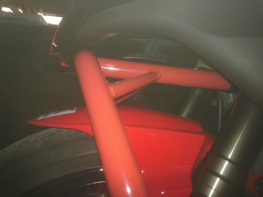

Update: Got the 27mm pin and it works like a charm. Just barely pushes up on the front fairing, but solid so far. Thanks for your help
