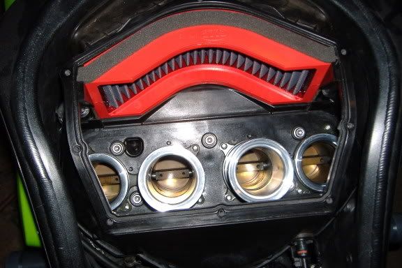

And it sure seemed like there was alot of crud built up in the velocity stacks and surrounding area.
Anyone else seen this? the picture shows one of many alcohol wipes i used to clean her up.
I inspected the airbox and it seems like everthing is sealed fine.

mine was dirty too this is an after shot there was major debris in there

Cool I was worried I had some sort of leak, nice stacks by the way!

Yeah it's pretty normal depending where you ride.I put some k&n sealing grease around my filter when i put it back in last time after cleaning it.

thanx KaTooM yea seemed a bit more stuff in there than shoulda been but I do live in a high debris environment

I put a thin layer of wheel bearing grease on the floor of the air box
by the throtle bodies and where the air tubes connect, this way if the dirt comes in it will get caught by the grease instead of going down the throttle bodies.
