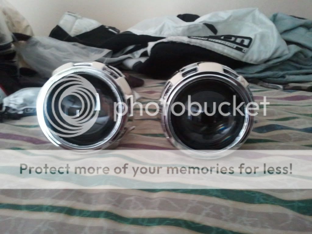

heres a pic of the projectors i used:
they fit into the stock housing without any modifications at all its a retrofit dream come true.
