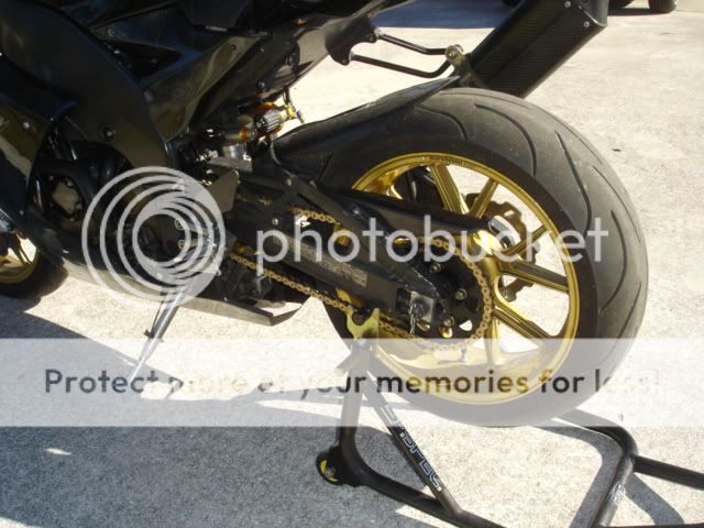

So as for the test ride I had to wait another day because I was still waiting on my chain to come in. My stock rear caliper wound up seizing on me one night destroying the chain and rotor. I bought a DID ERV3 120 gold linked chain off ebay for $129 bucks shipped to my door. As for the rear brake set up, I’ve been drooling over a underslung brake set up, I even tried to modify a stock bracket to work but not to much luck… I also wanted to upgrade the master cylinder. I had a zx14 caliper laying around and I thought to myself this sucker is massive compared to the tiny little zx10r caliper must need a bit more fluid flowing threw the lines to pump this massive caliper. So for a little under $20 dollars on ebay and asking a local buddy of mine to take some measurements I found a ZX-14 rear master cylinder to mount up to the bike. A perfect fit!!! I’d really like to see someone use this master cyl on a stock application and see if any difference…. Anyways I bought a used ducati 999 Brembo rear caliper for $50 shipped and I bought a new bracket ($100 shipped) that is supposed to only work for ZX-10r’s that have aftermarket wheels like my Marchesini’s I also really wanted to completely clean up the rear end so for a temporary solution to my orange HEL brake lines a wrap with electrical tape turned them black lol.
Pic of the chain

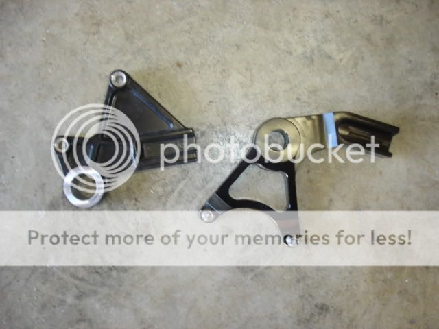

OK well I received the under-slung caliper bracket today and the first thing I notice is the bolts they supply looks like the head will break right off, luckily I had 2 Titanium bolts laying around that will work perfect. Also the powder coating they use on this bracket is good but they coated the inside hole where the axle goes…. That needs to be cleaned up and made sure the axle will slide right threw…. And another thing I noticed is that the spacing for the caliper mounting points are actually in a lil bit to much but can be easily cured with a washer between the caliper and the bracket. Without the washers the outside pad does not have enough room to let the caliper move around and will slightly drag against the rotor.
Here are the brackets side by side
Here is the inside bore cleaned up and trial fitted with axle
Heres the brake set up complete
I just need to get a new SS brake line for it, I had a brake line laying around that fitted up to her and will work for now but I need to get a line only a few inched longer.

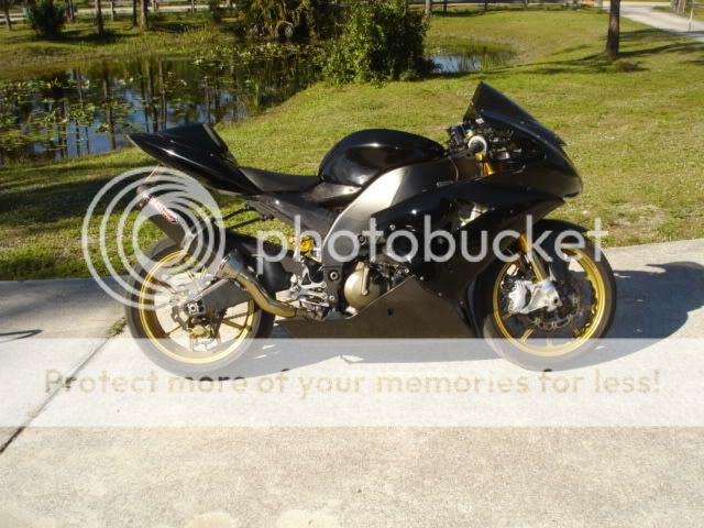

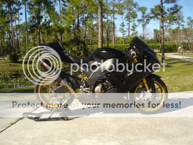

And here is the finished product along with the list of mods done to it. ENJOY!!!
Body and Chassis
• Zero Gravity Double Bubble Windscreen
• Vortex gas cap and base
• Pazzo shorty black levers
• Rear tail light with integrated turn signals
• Removed under tail, misc plastic pieces, unnecessary brackets
• Lightened stock rearsets
• Mirror Block off’s when not using mirrors
• Single Beam Headlight with slim HID kit
• Rear solo cowl with light weight cushion
• 06' ZX10r Race fiberglass upper
• Carbon fiber belly pan
• Carbon fiber mirror covers
• Carbon fiber front fender
• Carbon fiber tank sides
• Carbon fiber heel guards
• Carbon fiber rear fender
• Carbon fiber chain guard
• Vortex Lowering Links 0, 1.5, 2.5"
• Fully Adjustable aluminum kickstand
• PMR Stealth Kill switch
• Removed seat cushion for race seat, also have a stocker
• Vortex clipon bases with carbon fiber bars and titanium hardware
• Kawasaki KIT 60* Throttle
• GPR Steering stabilizer
• Ohlins 06-07 R&T forks
• Ohlins 46 prxls shock
• Titanium Rear-set bolts
• Titanium Upper triple tree bolts
Engine
• Yoshimura Stainless steel headers with Carbon fiber TRC can
• BMC race Air filter
• All short stock velocity stacks
• Removed secondary throttle plates and shafts
• 06-07 12 hole 330cc fuel injectors
• Valve cover block off’s and re-routed crank case breather
• 06' ZX10 Radiator – removed radiator fan assembly in winter
• Woodcraft Engine covers L & R
• Barnett 100 lbs clutch springs (3 of them)
• Carpenter springs and titanium retainers
• My own personal high velocity head porting decked .015" and thin head gasket
Electronics
• Dynojet Power Commander USBIII
• Dynojet Quick Shifter
• Daytona Sensors WEGO3 heads up display AFR and datalogger
• Speedohealer V4
• Hacked ECU with 13,500rpm rev limiter by "Guhl Motors"
Wheels and brakes
• MARCHESINI 10 spoke MAGNESIUM wheels
• Pilot power 180/55 and 120/70 tires
• Braking full floating front rotors
• Braking rear wave rotor
• Titanium Brake Rotor bolts front and rear
• Titanium Caliper bolts for rear
• ERV3 520 chain with different gearing 16,17,18,36, 37, 38,40, 41 sprockets (currently 16,40)
• ZX-14r silver front NISSIN calipers
• ZX-14r Master Cylinder Front & Rear
• Brembo rear caliper (off Ducati 999)
• Underslung rear caliper bracket
• EBC HH pads F&R
• HEL SS Brake Lines
• Rear brake fluid reservoir removed and installed short tube
