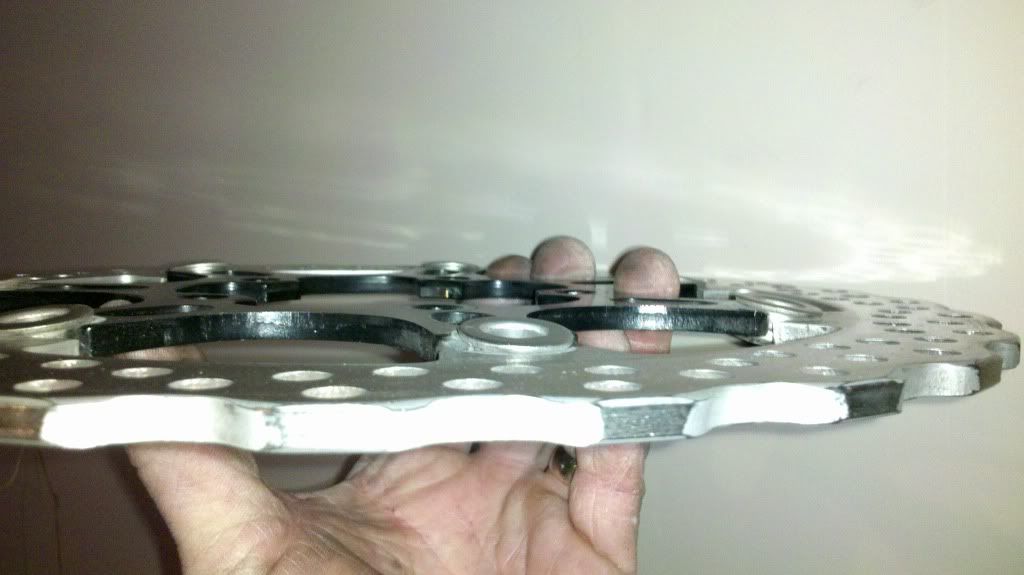

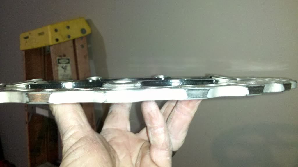

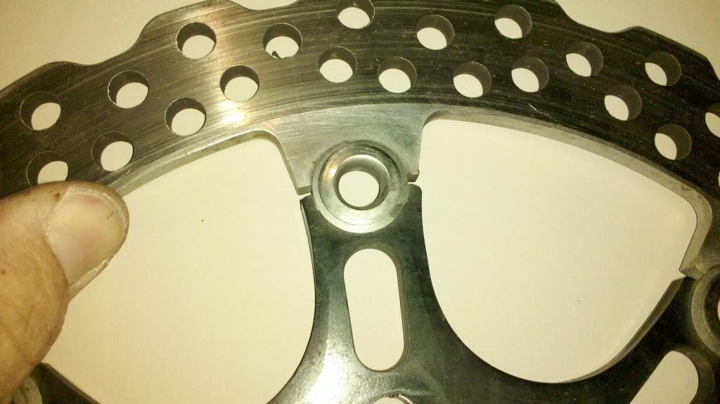

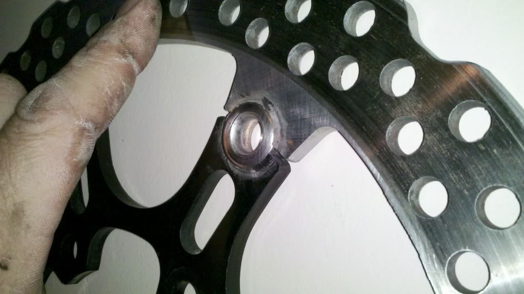

Stock
Springs removed
Sorry if the pics suck I took them and copy pasted then all from my phone. I used a small cut off wheel and cut into the washers at an angle between the button head and the rotor, patience is key. Then I used a couple screw drivers to pull the remainder of the spring out.
