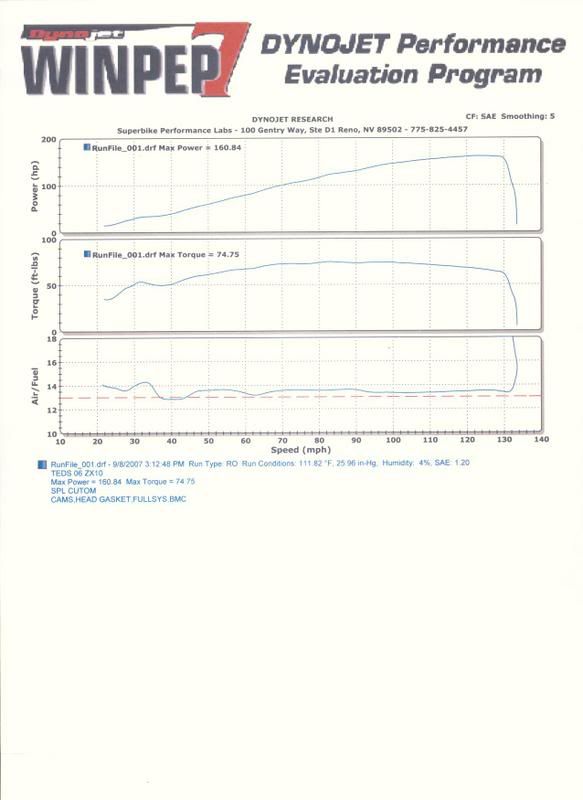

Hey everyone, I just got back from a dyno tune on Monday. I noticed that the bike pulls much harder and is smoother down low ~ midrange (almost night & day difference), but the top lacks. It seems to hit a wall around 140mph as in it no longer skips numbers on the speedometer. Wasn't like this before I brought it in. Before I brought it in it was running on a generic map from the HR1 exhaust site and pulled like a champ up top. When looking at the dyno graph the numbers tell a different story than what I am feeling. FYI, the place I took it to is certified to tune PCIII, but they specialize in Suzukis' . Could that be it? I would like to know if any of you guys know what this could be? Time for a retune? Thanks!

hahaha, I would hate to ride that thing below 6.5k. Stock cam degree it seems. The a/f does not look bad. Although I am not a tuner by no means.

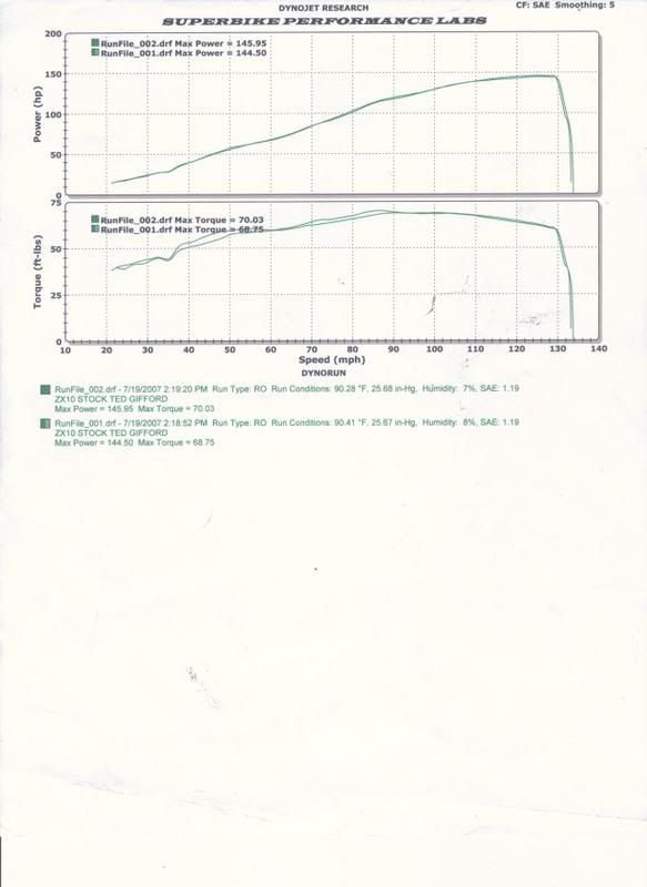

I was basically going off of my stock dyno run where the hit was in the same range with the a/f pretty much in the same area at 4500ft elevation. Not as big of a hit as in that run, but similar. (although the hp numbers are a lot higher than mine as a reference on that dyno)
the a/f is jacked down low in this graph(which kills entry and mid corner smooth throttle control), but with the cams degreed 106/104

it could be now its a/f ratio tuned so it might feel a lil low as tuning to an a/f ratio kills power, what are your mods?

They are listed in the sig. BMC race filter, PC3, HR1 Riot pipe, butterflies removed, and 1/5 throttle mod.
