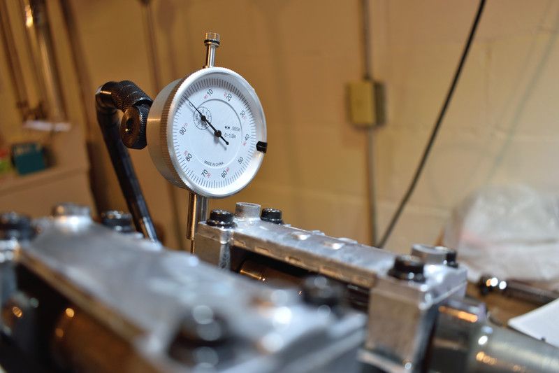

Well life has been pretty busy lately and I haven't had a ton of time to work on this thing but have been slowly working on it when I get a bit of time. I think I was the slowest person ever to do a valve adjustment between finding time put it together, finding smaller shims, ordering correct shims I never thought I'd finish lol.
This morning I was able to finish up degree-ing the cams to 111 intake and 108 exaust per Jim's recommendation. Hopeful I can get all the little things back on the motor this week and motor out of the basement and into the bike this weekend/next week then slowly start putting it all back together!

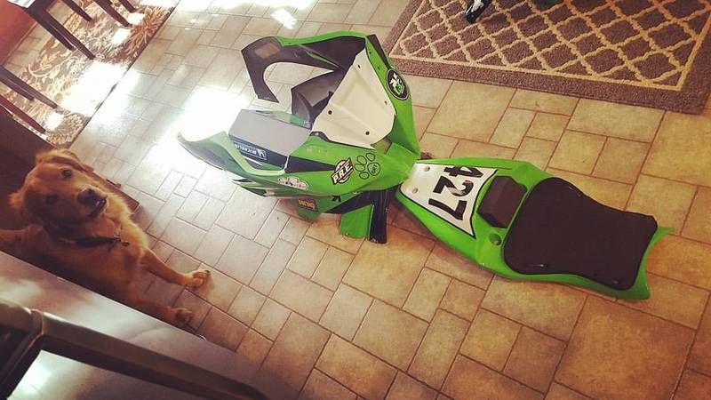

I also found a really good deal on some race body work on the forum and pulled the trigger. Some night coming up I'm going to try and weigh the difference between the race fairings and stock stuff.
