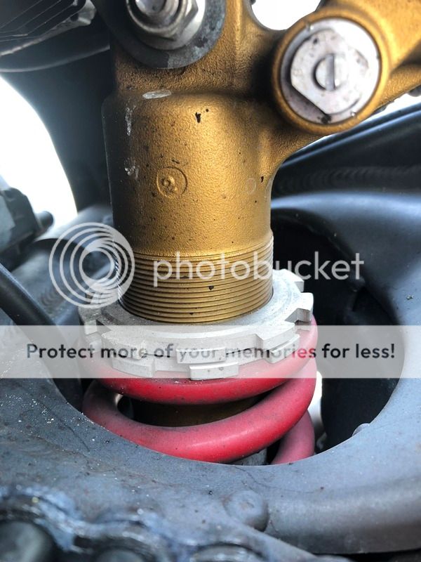

Quick story on my bike: it was a track bike that I picked up cheap to fix, clean up, & convert to street. The guy [I bought it from] told me he paid someone to "setup" the suspension for him whom was around 220 w/gear... I'm 270 out of the shower. Whomever "set up" the suspension had the shock preload so stiff that I'm getting 3/4" of sag in the back, and the fork preload was at half. I was speaking a couple days ago with a regional racer, Seth Starnes, that gave me some baseline comp & rebound settings, that I used, and the bike is acting dramatically better on the street. Biggest change was I maxed the fork preload which seems to had evened her out a lot.

If you were a customer in my shop, I would recommend a full teardown. The reason why is pretty simple, you have a TON of weird things going on. Are they stock springs, stock valving, are the comp adjusters changed out? If you're not 100% sure whats inside your suspension, there is a very good chance you'll be chasing scenarios and wont be able to figure out solutions. By having all your variables known, you can make much more educated decisions.
The other reason why I would highly suggest pulling everything apart is the last "tuner" clearly did somethings wrong, and without pulling everything apart you wont know your suspension is 100% safe!
