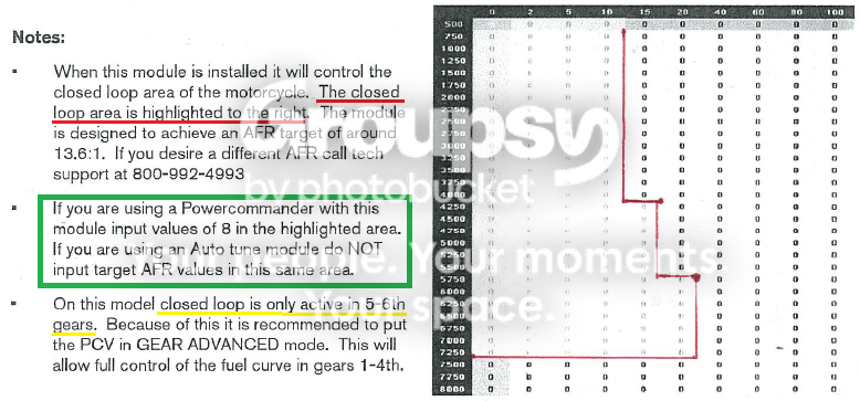

Lightbulb O2 Optimizer/Eliminator pics
Received my Dynojet O2 Optimizer/Eliminator yesterday, below are pics of what this mysterious device looks like and the instruction sheet that it comes with.
This device came via Serco who are the Australian Dynojet distributors. I have emails from Serco stating that this part is absolutely necessary if running a PCV on an Australian G4.
NB that the Australian G4 O2 Optimizer/Eliminator has a different part number to O2 Optimizer/Eliminators from Dynojet in the USA.
Sticker on the top side of the black box
Click to see installation instructions (yep, can't read the graph :()
Added new instructions sheet with legible range section:
A.
Last edited by arc; 05-25-2012 at 06:56 AM. Reason: Added new instructions sheet with legible range section:
A.
Sooooooo........what happens if you don't have one?
I am running a PCV and Akropovic with a link pipe with no O2 optimiser.
It runs just fine.
I am mystified as to why this part exists.
If it is to get the last 2 - 5% performance then for those that need/want/can handle a few extra horses I can see the point.
But unless the pistons are going to melt or burst through the crankcase then why is it absolutely necessary?
Seriously, I would like to know why they insist it is so important, if anyone knows?
Here is a repost of mine from the other thread ARC was discussing this in.
"I run the 02 Optimiser.
From what I know your ECU tries to change your Air Fuel ratio at certain rpm's which helped to get the bikes past emissions testing.
The problem with that is that it effects performance and your Power Commander being a piggy back off the ECU deal, can't take control over that range.
The 02 Optimser will basically wire inline with your factory 02 sensor and should delete the ECU's ability to lean that area of the rpm out.
Ideally I think it should have been dyno'd with the 02 optimser on there but oh well, better late than never".
That thread is http://www.zx-10r.net/forum/showthread.php?t=115086
Your bike won't explode without it but you won't get the full benefit of your tuning capabillities without out.

I have also come across some love in this area after some intense discussions with a multimeter and my old electronics text books.
It is possible to fool the ECU into thinking your sensor is still attached by building your own eliminator. This is nothing more than a 330ohm resistor in the right place.
This makes the ECU think the sensor is feeding it a zero voltage. So it doesn't try to play with the AF mix because it doesn't see anything move.
However, tuning needs to occur after this mod for best low end response. Never the less, by bridging the two white pins in the O2 sensor plug with a resistor you will definitely notice some more response down low, that should remain consistent.
This is all in theory so far... But I'll be putting it into practice tomorrow. I'll let you know how it pans out.

The area affected by this is the closed-loop region, which is part throttle and lower revs. There's no need to run a rich air/fuel ratio down there. If the rider wants more power, they open the throttle and presto, it's not in the closed-loop region any more. Lean air/fuel in the cruising range will give better fuel consumption and keep the engine cleaner inside (less carbon build-up) and reduce fuel dilution in the oil. I also don't see the need for this ... unless the transition between closed-loop and open-loop is causing driveability problems. On two bikes that I've played with that have an O2 sensor and aftermarket fuel controllers (not this one) the transition between closed-loop and open-loop is absolutely seamless, even after changing stuff in the engine. No need for it.
For your average road rider not chasing an optimum tune then yeah why bother but for those spending there money on a dyno tune that are seriously chasing the best results and want a smoother, easier bike to deal with down low then I'd stick an 02 Optimzer on there, get your bike dyno tuned and get the full benefit of what your paying for.
Why would you want your ECU mucking around with your AFR in anyway when you've paid good money to overide the ECU?
Personally I dont care about emissions or fuel economy, I want ridabillity even more so than outright hp and for me I did feel that my bike felt snatchy from closed throttle and abnormally fluffy in the bottom end. Put it this way the issues where enough for me to start searching for a fix to the issue and my tuner already new all about it.

The natural resistance of the sensor is 10 ohm cold, and about 14 ohm hot. Technically it wont matter if the resistance is higher than that of the original, it would only be an issue if it were lower. The signal the ECU receives in order to adjust AF has nothing to do with resistance... it is solely based on the voltage the o2 sensor sends back on the other 2 pins.
330ohm seems to be the consensus across most 3rd party eliminators, so im going to give that a go myself and see what happens.

10 ohms was for the two grey heater wires - Caprice measured the resistance of the heater circuit and the 10 ohm resistor keeps the FI error code at bay. Not sure about the 330ohm resistor on the ECU signal though...
I've got an O2 optimiser coming with a PCV this week (hopefully!). Even though the O2 sensor is removed in mine, I will be using the optimiser table to neutralise any adjustments from whatever signal it’s currently getting.
Will update this thread with results
