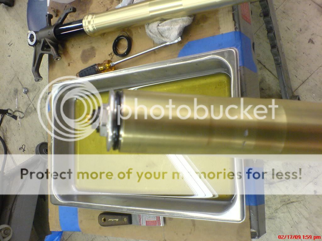

Now you can pull the upper fork tube off of the lower and get ready to remove the seals.... first off with a flat blade you can pry the dust seal off...
Then remove the clip on top of the fork seal
Now you can pry the fork seal out of the fork easiest way I do it has been just to have a large flat head screw driver and gently pry it out of there just be careful not to scrape the inside of the fork
Now that that is removed remove the washer/spacer remembering what way it was facing which is important!
Clean the tube inside and out, simple green mixed 50/50 with water.. a good wash and a blow dry with an air chuck and she will be ready to be put back together.... now its going to be the reversal of assembly.... install the washer and place the new fork seal back into the fork... I actually usually just take the old fork seal and place it on top of the new one and use a rubber mallet to press it back into the fork. this is where there are multiple ways of driving a fork seal. I prefer my method when doing seals it has always been easy for me.
